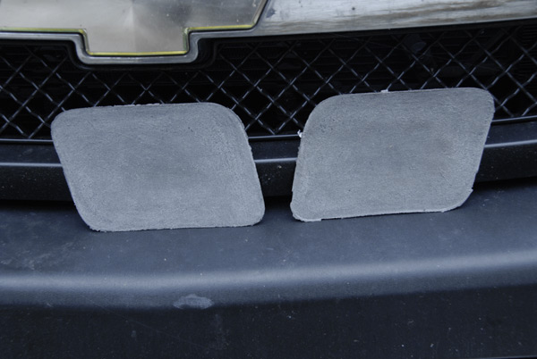

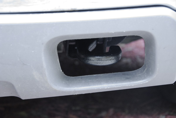

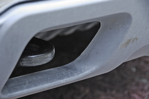

    Shamed into after-the-fact pics.
    Not sure how much help they'll be but here they are.
    This is what was sanded away and removed
    A nice clean opening
    You remove the valance and sand from the back side
    Another clean opening

    Wow I was kind of wondering how those holes came out, I was seriously doubting what you were saying in your original post. Now that I see it that is awesome, I have to remove those out of my new truck and I am dreading it because mine won't come out like that. Great job though, that has got to be the cleanest removal of those I have ever seen.

    wow that does look factory, great job
