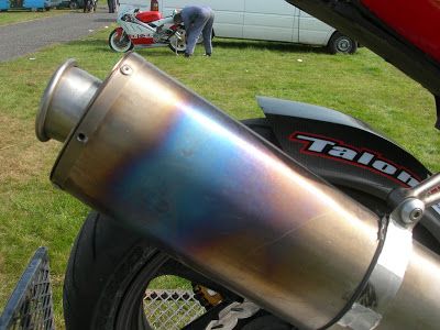

I looked at all the fuses and while none of them were blown (the wire anyway, I can't find anything not working yet apart from the no start) a bunch of them had bluish discoloration on the legs like when you hold a torch to titanium. No charring just the discoloration. I attached an image of what the discoloration looks like in general on a muffler since I don't have any photos of the fuses themselves doh
