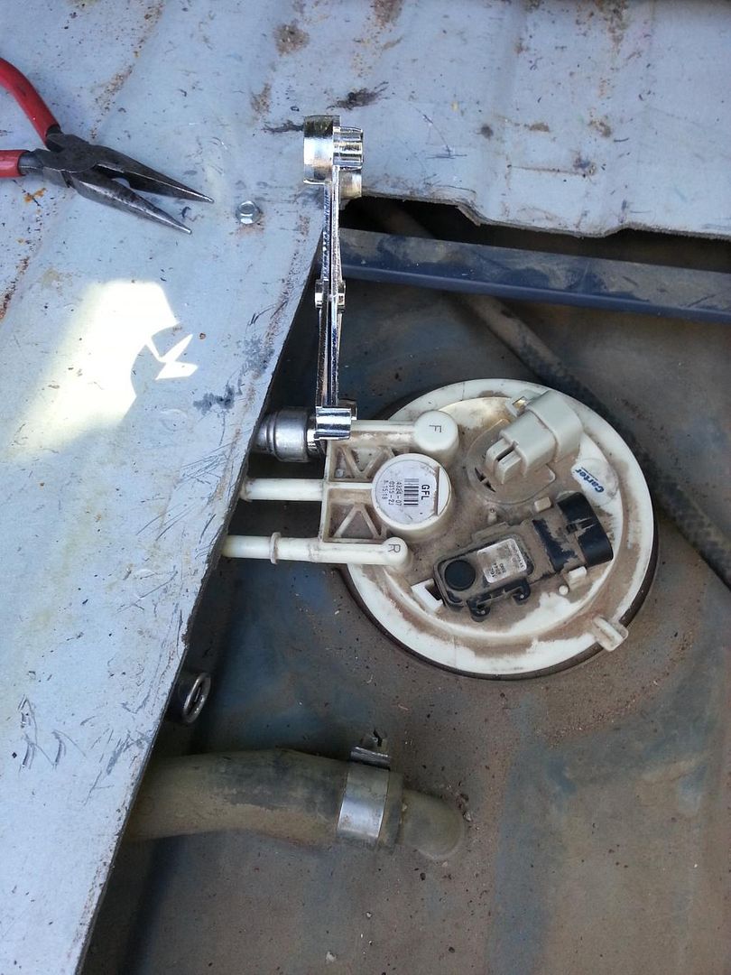

I replaced the pump...just the pump, not the entire assembly. (I didn't have a couple hundred bucks when the pump itself was $40!) Ran fine.

After I swapped this pump, the internal fuel line popped off twice, so I'm guessing I got air in the lines, then I was babying it pretty bad...I usually drive rather aggressively, so I think between the sedate driving style and air in the line, it starved out, then the crap battery failed so it stayed starved. Once I did a lot of cranking testing the pressure and the spark, it reprimed and flushed it out.
