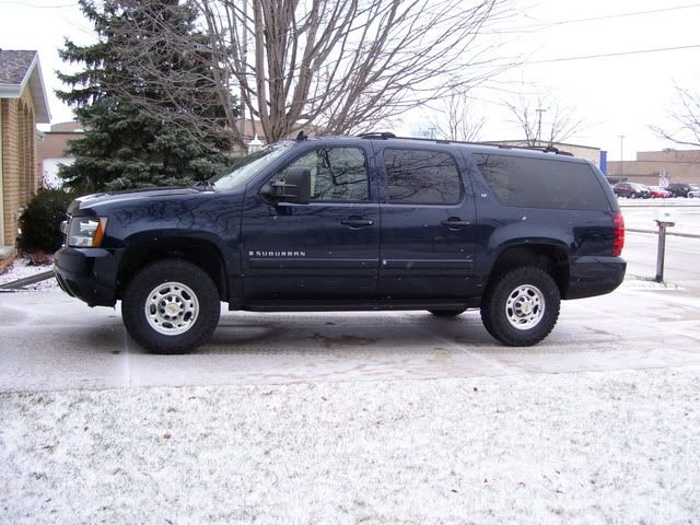

My 07 2500 is leveled out and i went with 265 Duratracs. when i back out of my driveway and turn the wheel hard right, i get a slight rubbing but thats about it so not sure bout 285's.
That looks good, do you know what the exact parts you purchased to level it and what is the benefit to leveling? I think what I need to figure out is how much bigger the actual diameter of the total wheel and tire when I change to 20" rims. I know the sidewall is lower if I am going with 285/55, but I dont know how much difference it calculates to with the bigger wheel itself.
