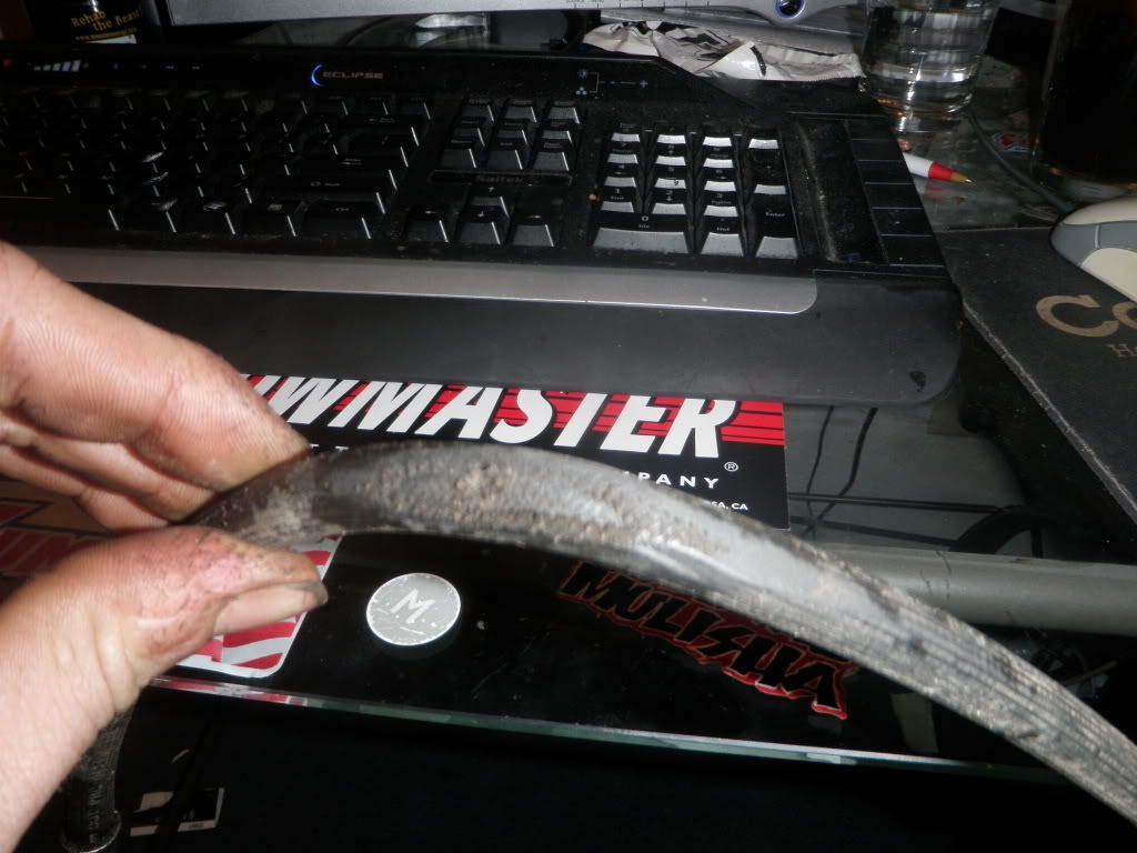

All right, So Monday night, my passanger side brake hose blew out on me on my way home from work. Ended up driving the truck home with barley any brakes. Scary, very scary. This was the damage

Looks like the other one was rubbing on something
Super Moderator
3,415 Posts
Yep, definitely had rubbing issues.
