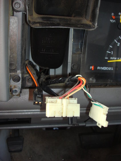

here are the head light and dimmer and rear window latch and door bypass switch connertors.

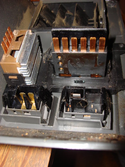

if you look at the bottom of the head light switch you can see this grey oilly residue. still not too sure what it was (the lights still worked as did the dimmer--just the smoke)

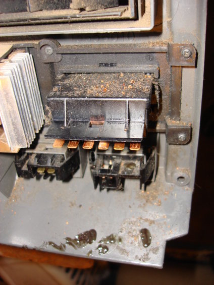

this is the top of the switch and this is why i think the po put coffee or soda on the top of the dash.
