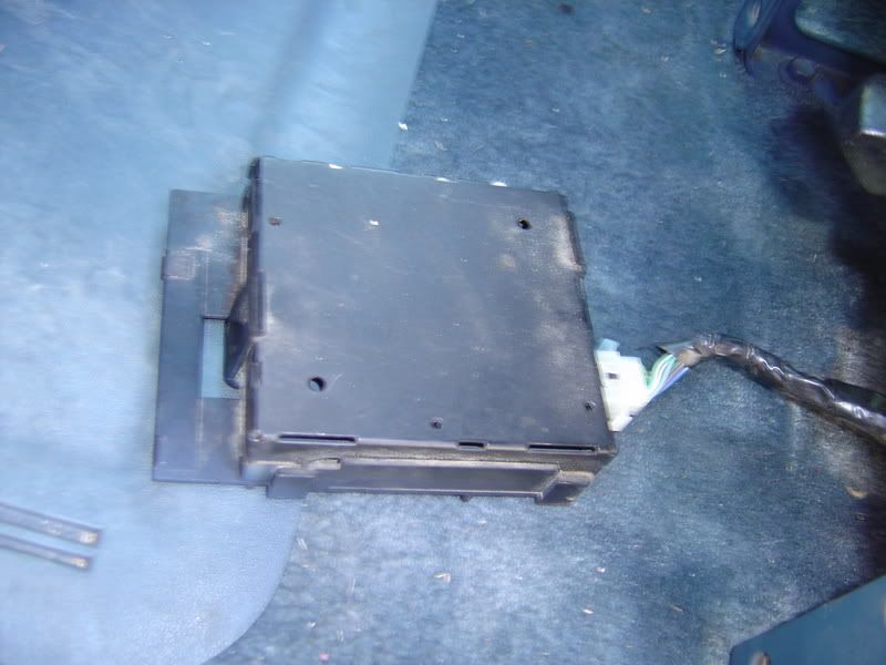

Alright boys and girls. I noticed a small box plugged into a harness under my seat. It's a Delco part, model 16152531 (serial 2071496). See picture below;
I started the truck with the module in it's current location and also unplugged and there was no change. I've searched the web looking for performance parts, original parts, and used parts and haven't come up with anything. Does anyone know what this darn thing is and what it does??
Any help would be appreciated, thanks!

I've got it too. I noticed it some time back, and thought it had to do with the seats.

I've got one about under the drivers seat of my 96 4x4. My neighbors 95 2wd doesnt have one. Maybe something to do with the 4x4 and transfercase.
Very possible. Now that this thread started, I was thinking maybe transmission controller.
My transfer case is all manual, the only electronic part of it was the Thermal Linear Actuator(TLA) on the front axle, the switch to activate it, and the light to indicate 4X4.
So the only thing that might control would be my 4L80E trans, not my 4x4. IMO

After looking at a GM, Delco site I can find nothing about that part number, but with those numbers I am wondering if its not the computer?

My ECU is behind my glove box. I've verified this since I had to replace the PROM in it when my father owned the burb before me.
Doesn't seem to make sense that if it were in two pieces it would be separated so far away from it's counterpart. IMO
Maybe it's time to tear into this box, and read the PC board. Maybe it will reveal something of itself.

I think it has something to do with the stereo. The reason why is that if you look at the wires, they are the same color pattern as the speaker wires going through out the vehicle. Just a thought!

I was informed that that is the module that controlled the speed controlled volume on the factory head units.
