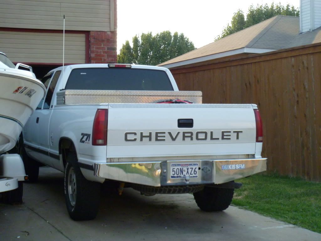

hey guys i was always wanting to paint my rear chrome bumper black, after doing some research i seen people paint their chrome with plasti dip spray can, which had me wanting to paint it more, since it bonds pretty good. i was wanting to fill the huge dent i have in the bumper also to give it a cleaner look. I was wanting an opinion on if i should or not. what do yall think? it and the front bumper and wheels are the only chrome accents i have left.

Rough guess on what it should look like (dont mind the tail lights, i got a little carried away. haha)

JUST PAINTED IT :) Used a little JB weld to fill in the holes, but the dents are still noticeable -.-. so i will put some stickers over them so it looks clean. This is what i did
1. Sanded it with 120 grid on a sander for maybe 20 minutes, so it would be a little rougher
2. Hand sanded it with 320 Grit,
3. Filled in the noticeable dents with some JB weld, i did good on all the small ones, but the bigs ones are still a tad noticeable
4. Primed it with some Rustoleum Self Etching Primer. Let dry for 15 Minutes
5. Once it dried, I wet sanded it with some more 320 Grit, BY HAND.
6. Primed it again. Same way last time. Let it dry for 15 minutes
7. Broke out the plasti dip and did one coat. Looks every good! no bubbles or drips or leaks.
8. Waited a good 25 minutes and did a second coat of Plasti Dip. Still looks good!
9. Might do a 3rd coat. Still debating.
Its still drying ATM. Im going to wait a good 2 hrs before I mess with it anymore.
The Buys:
-1 can Spray Plasti Dip - 6$
-1 can Self Etching Primer - 6$
-JB Weld Quick/Kwik - 3$
For 15$ I got a nice looking bumper! it was worth it! It had to be since my dad told me if it looked like sh*t when I was done, he was gonna kick my A*s. Hahaha, Thanks for viewing guys :)
