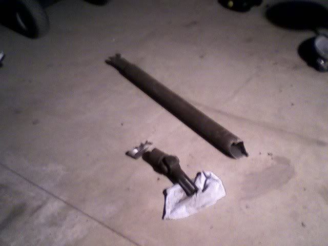

I dont know why it wouldnt do it in 4L, it has the auto locking hubs. I put it in 4Low and its made a WEIRD clicking and clanking sound and wouldnt drive. Heres a picture of the rear half of the broken driveshaft
Just to see the carnage again, sorry. Any idea if it is the original and how old?
its original from 1986 from my 1987 Sierra Classic...my grandfather thinks my transmission and/or transfercase might be trashed, anyone near maryland who knows how to rebuild a 700R4 if its my transmission?

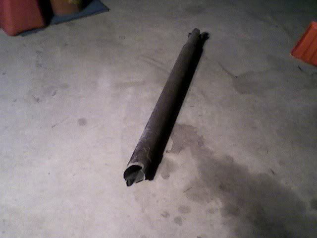

Here is picture after I pulled the other piece out and got the other piece(the small one behind the front half of my driveshaft)
Wow, I've never seen one get mangled like that. What were you doing again when this happened?
Sorry for the trouble on that, a driveline is one thing you never think about until something like this.
I was driving my truck back from my grandfathers (2streets over) and I had to turn in my alley and a car was coming toward me so I slowed down and when I went to accelerate to turn in I heard clunk clunk clunk SNAP. The area where it snapped the metal was kinda thin so it was a matter of time. Now when I put it in any gear it whines and clicks and clunks even when I put it back into park until it sits for a while. Tomorrow after I calm down and go get one from the junk yard I will see if it will work with the front one like other people said since now I got the front piece of the shaft out. I am just praying it aint got transmission issues since I still aint found a job.
