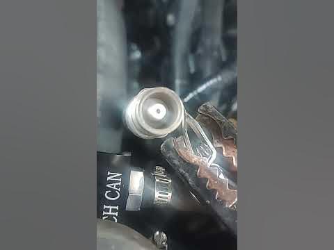

So I've been chasing for a long time a slightly rough idle that's throwing no codes. 2011 Sierra 1500 5.3 190k miles. I was checking spark and the spark defineley skips randomly. however it does it on every single one. I have a hard time believing that all 8 coils are going bad and doing the same thing. I will upload a video of the best shot of the spark, just keep in mind each coil is acting the exact same. So y'all think all 8 could be going bad or something else could be going on?

I have had someone point this out and I unplugged and checked all the pigtails going to the fuse box and the pigtails going to the ecu not a single pin was loose or corroded.

Yes I have checked every pin on the ecu and fuse box and of each pigtail and none of them are discolored or loose or corroded

Sounds like you need to verify the pulse to the coil trigger is the right power, rhythm, and not intermittent. I think you need a scope for that, though...
